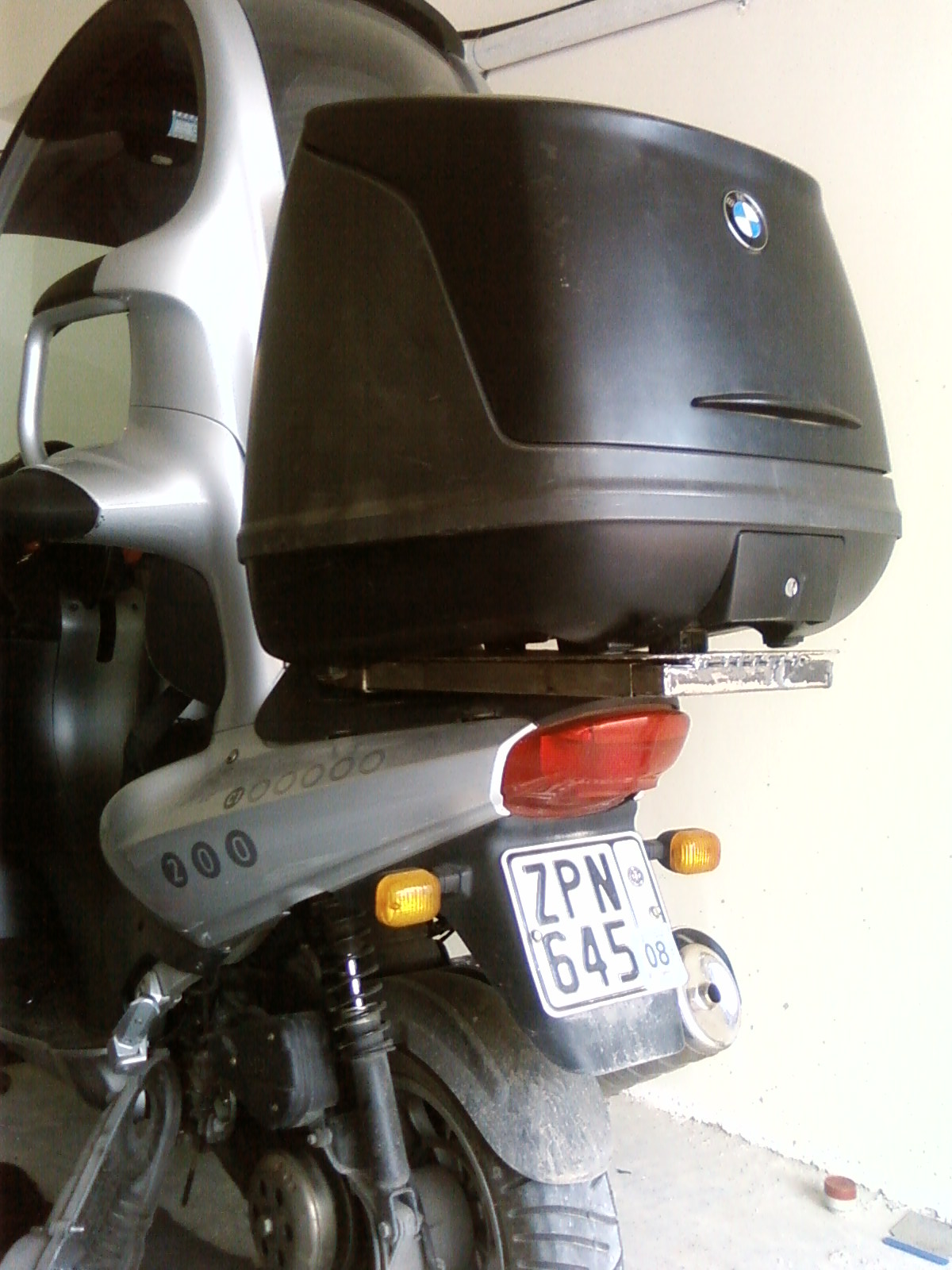

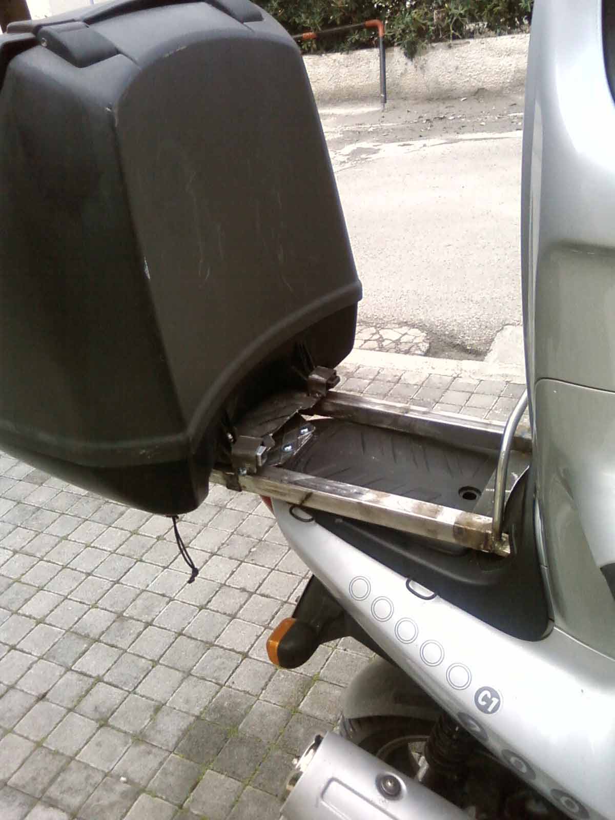

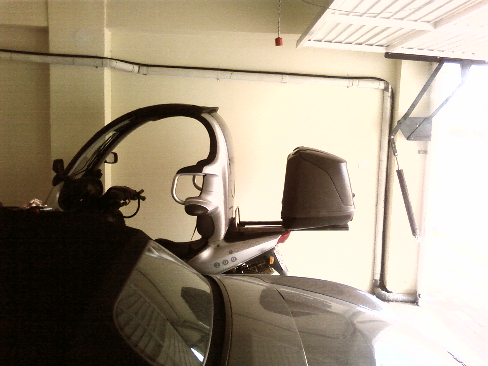

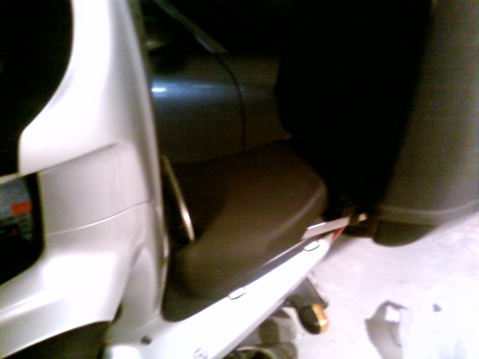

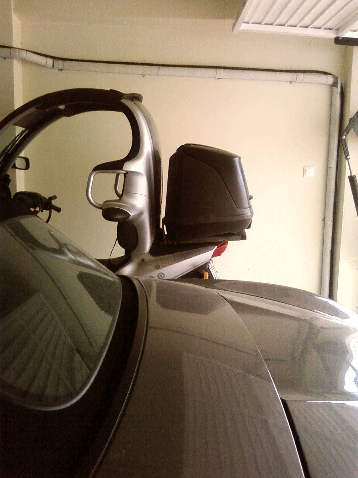

Here is my system!
1) the device is sliding
2) this means that the BMW embleem is always back!!
3) the seat is placed afterwards (just pushing it in)
4) note the clever double-sliding system that my mechanic thought of and makes it very stable and resistant
5) when closed you cant see almost anything at all !
90,41 KB
304,03 KB
331,55 KB
296,14 KB
186,08 KB

Ciao Aware, ben fatto.
Molto valida l'idea di mettere il sedile dopo per evitare di alzare il top-case troppo.
Questo ha permesso inoltre di avere uno scorrimento più stabile.
Forse l'optimum sarebbe fissare con un perno il sedile vicino ai piedini del top case in modo che quando si porta il top-case in avanti il sedile rimane tra la carrozzeria ed il top-case.
Hi Aware, well done!
Very good the idea to put the seat after in order avoiding to raise the top-case too much.
This has allowed moreover to have a much stabler sliding.
Perhaps the best would be to fix with a hinge the seat to close to the pins of top-case so when the top-case is ahead the seat remain between the bike body and the top-case.

1) The seat is placed but not loosely. It requires some force to put it. This way, even when riding over bumps with no passenger, the seat stays there!!
2) The removal of the seat has an additional advantage: you may caary huge items between the top-case and the body without harming the seat..
3) I also would like to say here that Nube was the person that helped me a lot in order to make this marvel! (although we live in different countries)
Regards
